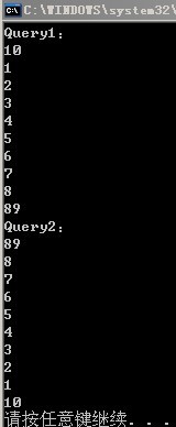

2.用OrderBy()方法进行排序
using System;
using System.Linq;
namespace ConsoleApplication3
    class Program
        static void Main(string[] args)
            int[] intary = { 1, 2, 3, 4, 5, 6, 7, 8, 89, 10 };
            //对所有元素按照%10进行升序排列,这是默认的排序方式
            var query1 = intary.OrderBy(val => val % 10 );
            Console.WriteLine("Query1:");
            foreach (var item in query1)
                Console.WriteLine("{0}", item);
            //对所有元素按照%10进行降序排列
            var query2 = intary.OrderByDescending(val => val % 10);
            Console.WriteLine("Query2:");
            foreach (var item in query2)

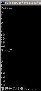

3.用Skip()、SkipWhile()跳过元素
 using System;
using System.Linq;
using System.Collections.Generic;
    class Program
            int[] intary = { 1, 2, 3, 4, 5, 6, 7, 8, 9, 10, 20, 30, 40 };
            //跳过intAry中前3个元素
            var query1 = intary.Skip(3);
            Console.WriteLine("Query1");
            //跳过intAry中小于5的元素
            var query2 = intary.SkipWhile(num => num < 5);
            Console.WriteLine("Query2");
