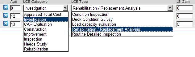

There is relationship between LCE Category and LCE Type. The items of LCE Type are gotten dynamically according to the selected item of LCE Category. When the certain item of LCE Category is chosen, the system will get dataset from the database via Store Procedure. The items of LCE Type will be updated.

I quote Parent twice in the following snippet. The first Parent is to get Cell which includes current DropDowList. The second Parent is to get Parent of Cell, Row.
