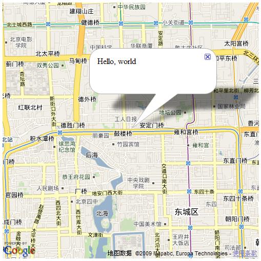

要创建信息窗口,请调用openInfoWindow方法,并向其传递位置和要显示的DOM元素。下面的示例代码显示了一个信息窗口,该窗口锚定在地图中心,内容为一条简单消息”Hello,  world”
<%@ Page Language="C#" AutoEventWireup="true" CodeBehind="Demo4.aspx.cs" Inherits="GoogleMap.Demo4" %>
<!DOCTYPE html PUBLIC "-//W3C//DTD XHTML 1.0 Transitional//EN" "http://www.w3.org/TR/xhtml1/DTD/xhtml1-transitional.dtd">
<html xmlns="http://www.w3.org/1999/xhtml" >
<head>
<title>Demo4</title>
<script type="text/javascript" src="http://ditu.google.cn/maps?file=api&amp;v=2&amp;key=abcdefg"></script>
<script type="text/javascript">
function initialize(){
var map = new GMap2(document.getElementById("map_canvas"));
        map.setCenter(
new GLatLng(39.9493116.3975), 13);
        map.openInfoWindow(map.getCenter(),
        document.createTextNode(
"Hello, world"));
</script>
</head>
<body onload = "initialize()" onunload = "GUnload()">
<div id="map_canvas" style="width:500px; height:500px;">
</div>
</body>
</html>
效果如图:
