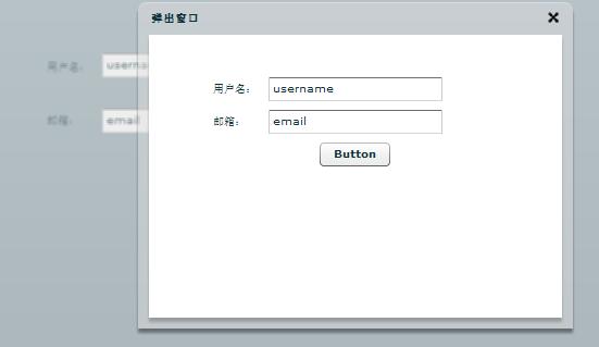

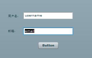

全部代码如下:
titleWin.mxml
<?xml version="1.0" encoding="utf-8"?>
<mx:TitleWindow xmlns:mx="http://www.adobe.com/2006/mxml" layout="absolute" width="400" height="300" showCloseButton="true" close="PopUpManager.removePopUp(this)">
    <mx:Script>
        <![CDATA[
            import mx.managers.PopUpManager;
            //[Bindable]
            //public var userName:TextInput;
            [Bindable]
            public var userNameInPop:TextInput;
            [Bindable]
            public var userEmailInPop:TextInput;
            private function showText():void
                userNameInPop.text=popUserName.text;
                userEmailInPop.text=popEmail.text;
                PopUpManager.removePopUp(this);
    </mx:Script>
    <mx:Label text="用户名:" x="57" y="41"/><mx:TextInput x="110" y="39" id="popUserName" text="{userNameInPop.text}"/>
    <mx:Label text="邮箱:" x="57" y="71"/><mx:TextInput x="110" y="69" id="popEmail" text="{userEmailInPop.text}"/>
    <mx:Button x="157" y="99" label="Button" click="showText()"/>
</mx:TitleWindow>
mainWindow.mxml
<mx:Application xmlns:mx="http://www.adobe.com/2006/mxml" layout="absolute">
    <mx:Script>
        <![CDATA[
            private function pop():void
                var popWin:titleWin = titleWin(PopUpManager.createPopUp(this,titleWin,true));
                popWin.title="弹出窗口";
                popWin.userNameInPop=userName;
                popWin.userEmailInPop=email;
    </mx:Script>
    <mx:Label text="用户名:" x="106" y="95"/><mx:TextInput x="159" y="91" id="userName" text="ssz413"/>
    <mx:Label text="邮箱:" x="106" y="144"/><mx:TextInput x="159" y="142" id="email" text="ssz425"/>
    <mx:Button x="207" y="189" label="Button" click="pop()"/>
</mx:Application>
