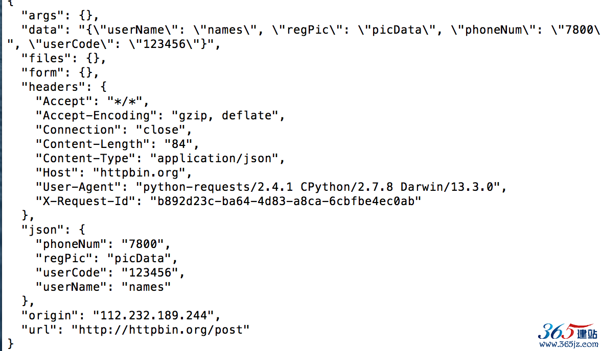

  如下 json参数,body
import requests
import json
payload={"userName":"names","userCode":"123456","phoneNum":"7800","regPic":"picData"}
headers={'content-type': 'application/json'}
burl="http://httpbin.org/post"
r=requests.post(burl, data=json.dumps(payload), headers=headers)
print r.text

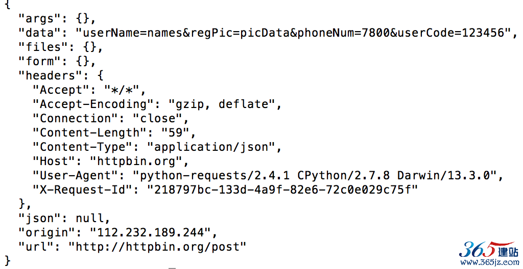

  如下 form 格式 参数
import requests
import json
r=requests.post(burl, data=payload, headers=headers)
print r.text
