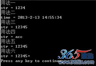

#include<stdio.h>
#include<stdlib.h>
#include<string.h>
int main(){
char str[100];
//用法一:取指定长度的字符串
sscanf("12345","%4s",str);
printf("用法一\nstr = %s\n",str);
//用法二:格式化时间
int year,month,day,hour,minute,second;
sscanf("2013/02/13 14:55:34","%d/%d/%d %d:%d:%d",&year,&month,&day,&hour,&minute,&second);
printf("用法二\ntime = %d-%d-%d %d:%d:%d\n",year,month,day,hour,minute,second);
//用法三:读入字符串
sscanf("12345","%s",str);
printf("用法三\nstr = %s\n",str);
//用法四:%*d 和 %*s 加了星号 (*) 表示跳过此数据不读入. (也就是不把此数据读入参数中)
sscanf("12345acc","%*d%s",str);
printf("用法四\nstr = %s\n",str);
//用法五:取到指定字符为止的字符串。如在下例中,取遇到'+'为止字符串。
sscanf("12345+acc","%[^+]",str);
printf("用法五\nstr = %s\n",str);
//用法六:取到指定字符集为止的字符串。如在下例中,取遇到小写字母为止的字符串。
sscanf("12345+acc121","%[^a-z]",str);
printf("用法六\nstr = %s\n",str);
return 0;
