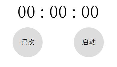

<!DOCTYPE html>
<html>
<head>
  <meta charset="UTF-8">
  <title></title>
  <style>
   body{margin:0;padding:0;}
   .box{margin:10px auto;width:400px;}
   #showtime{margin:20px;margin-bottom: 20px;text-align: center;}
   span{font-size: 60px;}
   button{width:100px;height:100px;border-radius: 50px;border:0;outline:none ;margin:0 48px;font-size:24px;}
   #record{margin-top:20px;}
   #record div{width:400px;height:30px;border-bottom:1px dotted #666;}
   #record span{font-size:20px;}
   .left{float:left;}
   .right{float:right;}
  </style>
</head>
<body>
  <div class="box">
   <div id="showtime">
    <span>00</span>
    <span>:</span>
    <span>00</span>
    <span>:</span>
    <span>00</span>
   </div>
   <div class="bnt">
    <button>记次</button>
    <button>启动</button>
   </div>
   <!--记录显示的次数-->
   <div id="record">
    <!--/*<div>
     <span class="left">第一次记录:</span>
     <span class="right">00:00:00</span>
    </div>*/-->
   </div>
  </div>
  <script src="http://apps.bdimg.com/libs/jquery/2.1.4/jquery.min.js"></script>
  <script>
  //添加事件
  $(function(){
    var min=0;
    var sec=0;
    var ms=0;
    var timer=null;
    var count=0;
  //点击第一个按钮
   $('.bnt button:eq(0)').click(function(){
    if($(this).html()=='记次'){
     if(!timer){
      alert("没有开启定时器!");
      return;
      count++;
      var right1="<span class='right'>"+$('#showtime').text()+"</span>";
       var insertStr = "<div><span class='left'>记次"+count+"</span>" +right1+"</div>";
      $("#record").prepend($(insertStr));
    }else{
     min=0;
     sec=0;
     ms=0;
     count=0;
     $('#showtime span:eq(0)').html('00');
     $('#showtime span:eq(2)').html('00');
     $('#showtime span:eq(4)').html('00');
     $('#record').html('');
  //点击第二个按钮
   $('.bnt button:eq(1)').click(function(){
    if($(this).html()=='启动'){
     $(this).html('停止');
     $('.bnt button:eq(0)').html('记次');
     clearInterval(timer);
     timer=setInterval(show,10)
    }else{
     $(this).html('启动');
     $('.bnt button:eq(0)').html('复位');
  //生成时间
   function show(){
    ms++;
    if(sec==60){
     min++;sec=0;
    if(ms==100){
     sec++;ms=0;
    var msStr=ms;
    if(ms<10){
     msStr="0"+ms;
    var secStr=sec;
    if(sec<10){
     secStr="0"+sec;
    var minStr=min;
    if(min<10){
     minStr="0"+min;
    $('#showtime span:eq(0)').html(minStr);
    $('#showtime span:eq(2)').html(secStr);
    $('#showtime span:eq(4)').html(msStr);
  </script>
</body>
</html>
效果:
