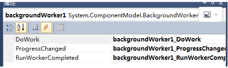

我们可以看到有如下三个事件:
1、线程执行的动作,一般用于复杂操作,DoWork
2、线程进度改变,进度条变化
3、线程执行完,这时候,又回到主线程执行了,可以访问主线程中的UI,操作主线程的UI

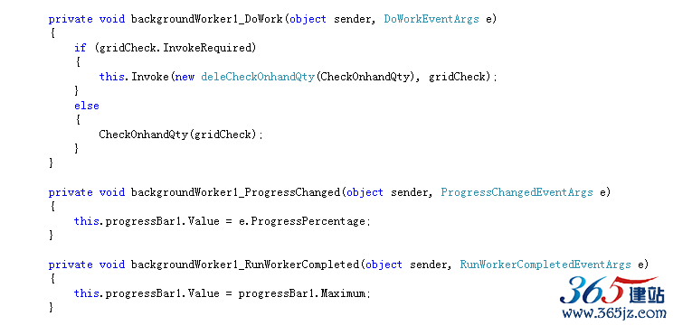

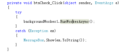

  1. private void buttonTest_Click(object sender, EventArgs e)
               BackgroundWorker worker = new BackgroundWorker();
               worker.WorkerReportsProgress = true;
               worker.DoWork += Bw_DoWork;
               worker.ProgressChanged += Bw_ProgressChanged;
               worker.RunWorkerAsync();
           private void Bw_ProgressChanged(object sender, ProgressChangedEventArgs e)
               labelProcess.Text = e.ProgressPercentage.ToString();
           private void Bw_DoWork(object sender, DoWorkEventArgs e)
               var worker = sender as BackgroundWorker;
               for (int i = 0; i < 100; i++)
                   worker.ReportProgress(i);
                   Thread.Sleep(100);

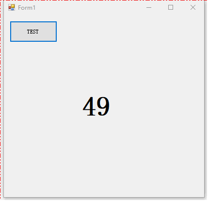

结果如下图
