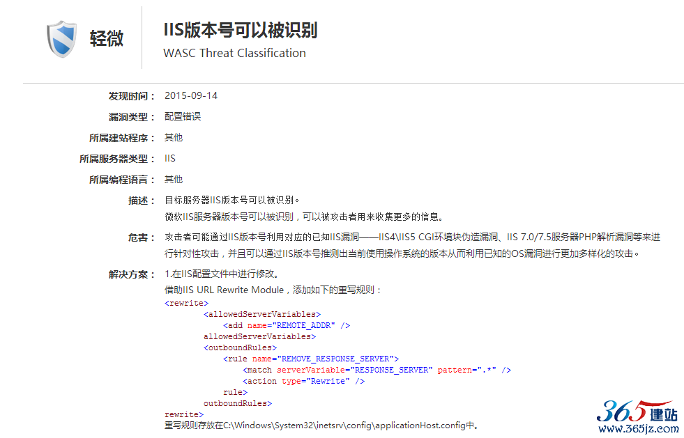

解决方案:
1.在IIS配置文件中进行修改。
借助IIS URL Rewrite Module,添加如下的重写规则:
<rewrite><allowedServerVariables><add name="REMOTE_ADDR" />allowedServerVariables><outboundRules><rule name="REMOVE_RESPONSE_SERVER"><match serverVariable="RESPONSE_SERVER" pattern=".*" /><action type="Rewrite" />rule>outboundRules>rewrite>
