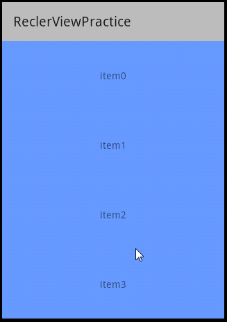

1.实现垂直方向的滚动
在   dependencies 中添加库的引用
dependencies {
    compile fileTree(dir: 'libs', include: ['*.jar'])
    testCompile 'junit:junit:4.12'
    compile 'com.android.support:appcompat-v7:24.2.0'
    compile 'com.android.support:recyclerview-v7:24.2.1'
添加布局文件:
<?xml version="1.0" encoding="utf-8"?>
<LinearLayout
    xmlns:android="http://schemas.android.com/apk/res/android"
    android:layout_width="match_parent"
    android:layout_height="match_parent">
    <android.support.v7.widget.RecyclerView
        android:id="@+id/recycler_view"
    </android.support.v7.widget.RecyclerView>
</LinearLayout>
创建RecyclerView 适配器 BookBaseAdapter ,这个类继承 RecyclerView.Adapter 并将泛型指定为 BookBaseAdapter.ViewHolder
其中ViewHolder是我们在 BookBaseAdapter 中定义的一个内部类:代码如下:
public class BookBaseAdapter extends RecyclerView.Adapter<BookBaseAdapter.ViewHolder>{
    private List<Book> mBookList;
    static class ViewHolder extends RecyclerView.ViewHolder{
        ImageView bookImage;
        TextView bookname;
        public ViewHolder(View view) {
            super(view);
            bookImage = (ImageView) view.findViewById(R.id.book_iamge);
            bookname = (TextView) view.findViewById(R.id.book_name);
    public BookBaseAdapter(List<Book> mBookList) {
        this.mBookList = mBookList;
<span style="white-space:pre;"> </span>//加载item 的布局  创建ViewHolder实例
    @Override
    public ViewHolder onCreateViewHolder(ViewGroup parent, int viewType) {
        View view = LayoutInflater.from(parent.getContext()).inflate(R.layout.book,parent,false);
        ViewHolder holder = new ViewHolder(view);
        return holder;
<span style="white-space:pre;"> </span>//对RecyclerView子项数据进行赋值
    @Override
    public void onBindViewHolder(ViewHolder holder, int position) {
        Book book = mBookList.get(position);
        holder.bookname.setText(book.getName());
        holder.bookImage.setImageResource(book.getImageId());
<span style="white-space:pre;"> </span>//返回子项个数
    @Override
    public int getItemCount() {
        return mBookList.size();
MainActivity调用:
public class MainActivity extends AppCompatActivity {
    private List<Book> mlsit = new ArrayList<Book>();
    @Override
    protected void onCreate(Bundle savedInstanceState) {
        super.onCreate(savedInstanceState);
        setContentView(R.layout.activity_main);
        //初始化List数据
        initBook();
        //初始化RecyclerView
        RecyclerView recyslerview = (RecyclerView) findViewById(R.id.recycler_view);
        //创建LinearLayoutManager 对象 这里使用 <span style="font-family:'Source Code Pro';">LinearLayoutManager 是线性布局的意思</span>
        LinearLayoutManager layoutmanager = new LinearLayoutManager(this);
        //设置RecyclerView 布局
        recyslerview.setLayoutManager(layoutmanager);
        //设置Adapter
        BookBaseAdapter adapter = new BookBaseAdapter(mlsit);
        recyslerview.setAdapter(adapter);
    private void initBook(){
        for (int i = 0; i < 10; i++) {
            Book book01 = new Book("Book"+i,R.drawable.icon01);
            mlsit.add(book01);
            Book book02 = new Book("Book"+i,R.drawable.icon02);
            mlsit.add(book02);
            Book book03 = new Book("Book"+i,R.drawable.icon03);
            mlsit.add(book03);
main_layout布局:
<LinearLayout
</LinearLayout>
item布局:
<LinearLayout xmlns:android="http://schemas.android.com/apk/res/android"
              android:layout_height="wrap_content"
              android:orientation="horizontal">
    <ImageView
        android:id="@+id/book_iamge"
        android:layout_width="wrap_content"
        android:layout_height="wrap_content"/>
    <TextView
        android:id="@+id/book_name"
</LinearLayout>
此处省略Book对象的相关源码。如上就可以实现和ListView一样的效果。
